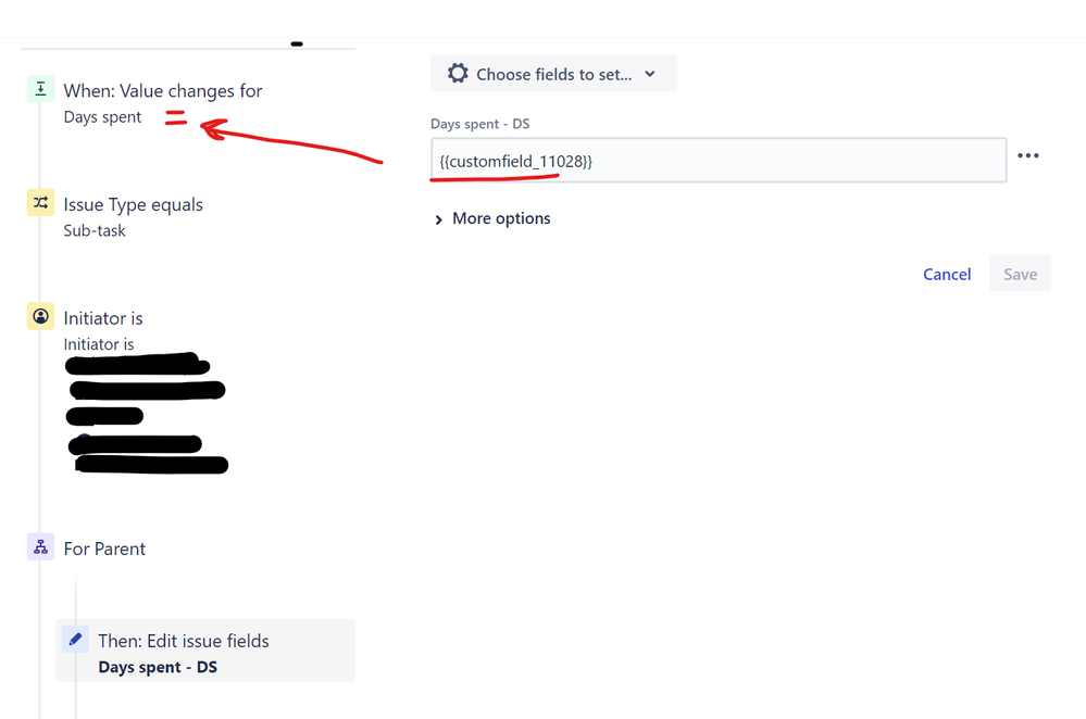

I've created an automation that takes a number value (from a custom field) in a sub-task and adds it to a field (also a numeric field) in the parent Story.
The automation shows 'Success' but the actual value in the story is None (instead of the numeric value from the trigger subtask).
I'd love to get some help here..thanks!

You are trying to copy the value from the trigger issue (subtask) to the parent issue, correct?
If so, you need to reference the trigger issue with:
{{triggerIssue.customfield_11028}}
If instead you are trying to sum the value for all children subtasks, rather than copy one, that would require a different value, using the parent to gather the subtask values:
{{issue.subtasks.customfield_11028.sum}}
Bill
Wow Bill it's working !! Thank you so much!
Such a tiny detail that took me hours to work on!
Thank again!
