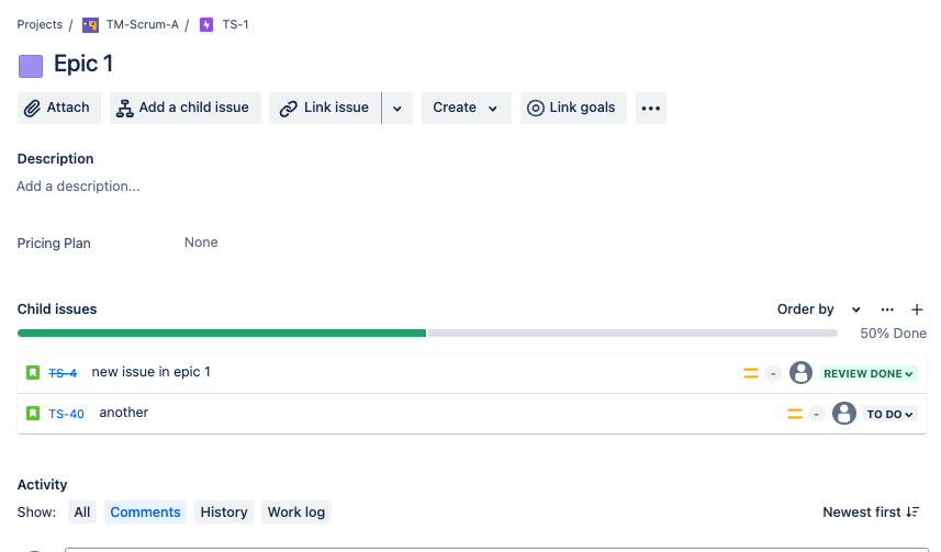

You have Epics that have issues appearing in the Child Issues section:
You want to add an issue link between these Epics and their Child issues so that the child issues also appear in the Issue Links section?

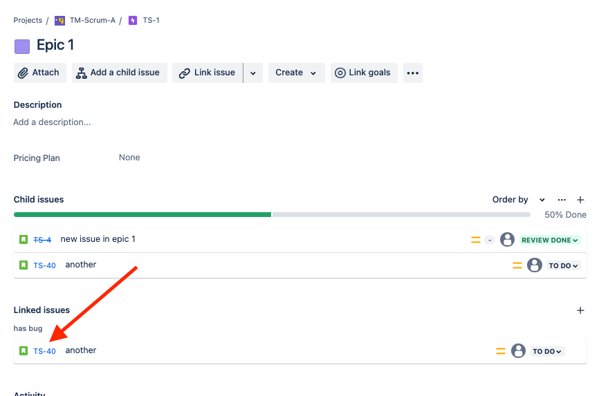

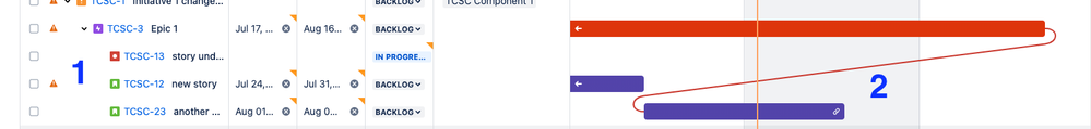

If you use a Dependency (issue link) as a secondary way to show the parent/child relationship between Epics and their child issues then the relationship will show not only in the hierarchy of the Timeline (1), but also as Dependency links in the Timeline (2). Is this a desirable outcome?

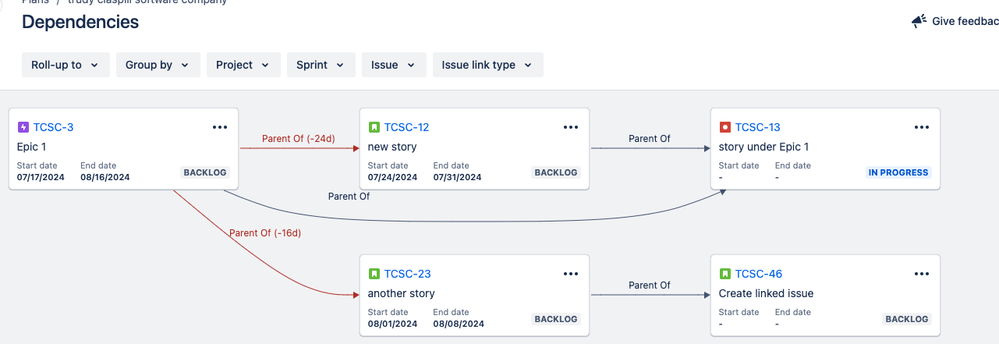

Is the Parent/Child issue link ever used to connect other issues besides an Epic and its child issues? If so, it seems like this could become confusing in the Dependencies view.
In the below example TCSC-12, 13, and 23 are the Child issues of the Epic, but because of other users of the parent/child link 12 is also a parent to 13. And TCSC-46 is a child of an entirely different Epic, but also linked to 23 with the parent/child link.
Add to this all the other dependencies links you might use and it seems like this visual could become very cluttered and confusing.
