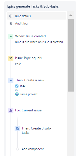

I have a question regarding the cloning of an Epic when it contains child issues (which also have sub-tasks). I'm currently trying to create a rule for it but can only succeed at the first layer, meaning the cloning of the Epic itself.
Here are the 2 attempts I've made so far:
For this second rule, I've indicated first level of cloning as Epic then Task then Sub-task that is why I've added the action 3 times.
I think I'm missing a step (or a few), any guidance would be much appreciated :)
Thank you!

Hi again @Luka Hummel - codefortynine just out of curiosity, I know you mention that setting up the automation would be quite tedious but can you share an overview of the steps if you have an idea? Many thanks!
I will try to give a basic overview of the steps. These are of course more complicated if you need additional field values copied or need to create more issue links.
FOR EACH Most recently newly created issue (Epic): Create issues and add parent field with Advanced fields under More options. {"fields": {"parent": { "key": "{{issue.key}}" }}}
