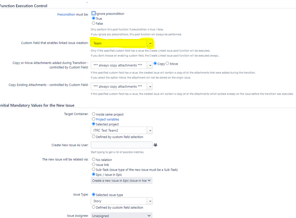

we have a requirement to create stories in different projects when we create an epic. but it should create only when the predefined custom field or a component filled
For example:
1. when I'm creating Epic in a project "A" with a component "X", it should create stories Story 1, Story 2, and Story 3 in the project" B".
2. if i'm creating epic with a component "Y", it should create stories in the project "C"
if I create an epic without that component "X", "Y" it should not create any stories just the epic.
We have JSU, Script runner plugins, version is 8.8.
any help would be appreciated.

@Ravi Sagar _Sparxsys_ thanks for responding. i want this to happen only when the predefined a custom field value given while creating a epic.
i don't see any condition in the script. how can I modify it?

@Bill Sheboy thanks for responding. I have tried with a post function based on the field "Team" as shown in the screenshot. but it is creating stories by selecting any team. but, i want that to create stories only when the team selected "A"
