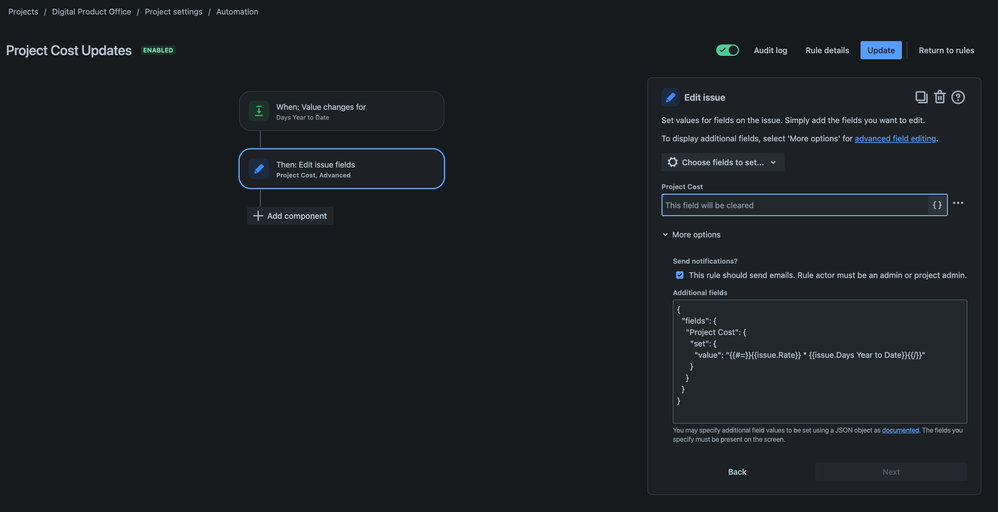

I am trying to add two fields and get a third using automation, I am using the Field Value Changed trigger, to monitor the Days Year to Date, then using an Edit issue and specifying the Project cost field.
In the more options I have this json
{ "fields": { "Project Cost": { "set": { "value": "{{#=}}{{issue.Rate}} * {{issue.Days Year to Date}}{{/}}" } } } }

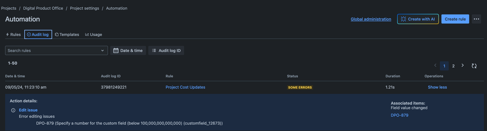

But get the error in the audit log.

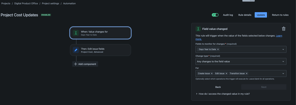

Thanks for your assistance, I have attached the two images of the Automation Rule, When: Value Changes (1st image) and the Then: Edit Issue fields (2nd Image) as well as the log report when I changed the field Days Year to Date.

Hi @Alfred Bailey - Don't know if you ever solved this or not, but basically it is telling you one of the fields used in your calculation is missing a value.
