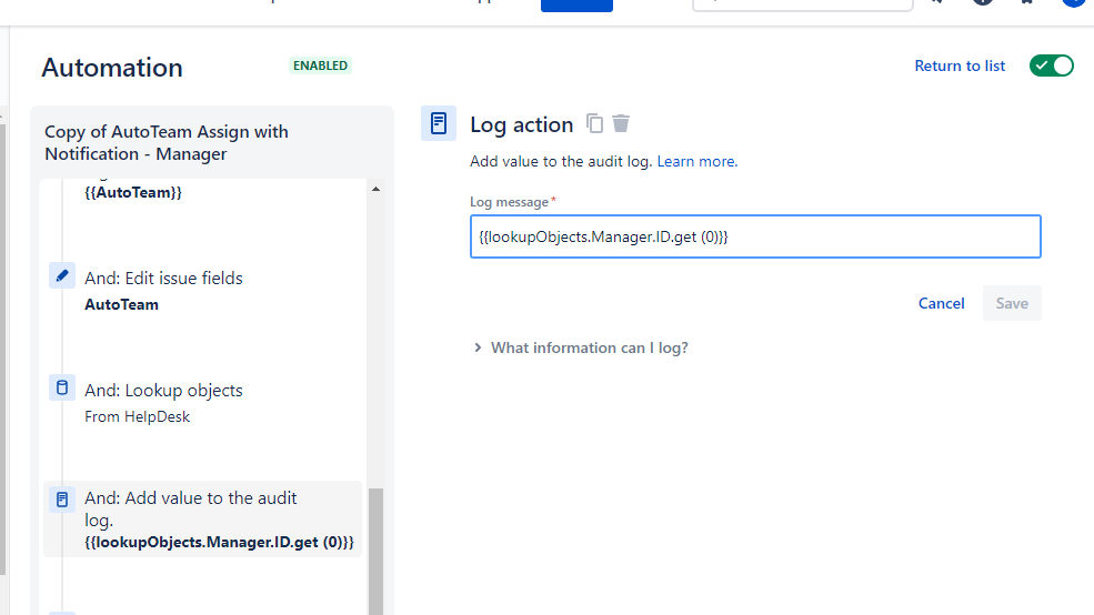

I have tried several options only to return nothing. This has been the most promising article I have found. It's also the article Atlassian support sent my way. Although every iteration attempted has returned and empty value

{{lookupObjects.Manager.flatten.asJsonObjectArray("id")}}
{{lookupObjects.Manager.Jira user.accountId}}
{{lookupObjects.Manager.Jira user.accountId.get(0)}}

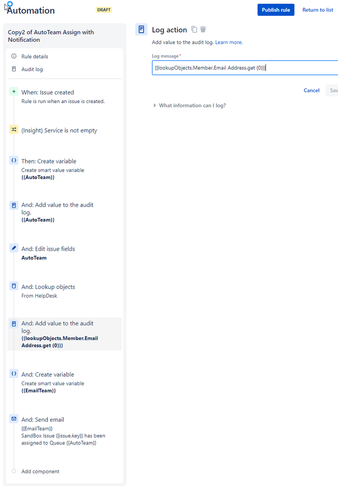

Appreciate the help Bill, I still am not able to pull anything in to the logs for User Attribute Manager. But when using Object Attribute Member I am able to pull everything needed in.
Hope this explains it a little better, I am clearly missing something. I suspect its with how User reads a variable vs an Object

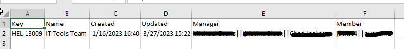

1: Eport from the IT Tools Team Object, Manager exports as First Name Last Name|| I was expecting an ID
2: Showing the team with multiple users in each attribute

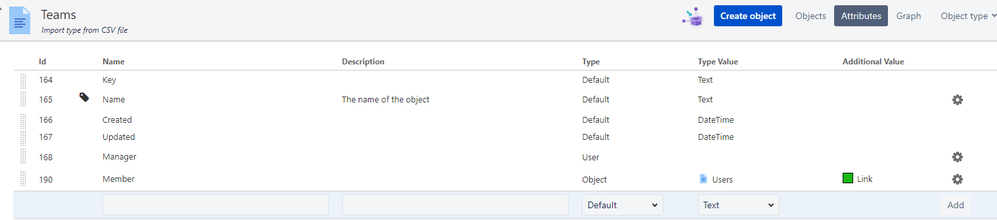

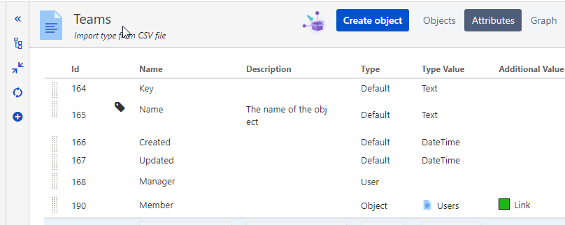

3: Showing the Team Attributes

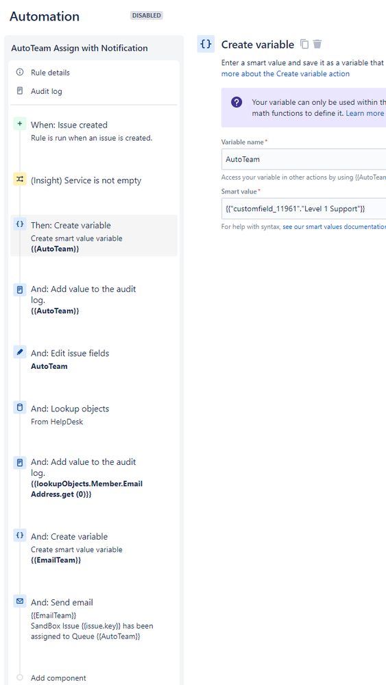

4: Automation being ran
