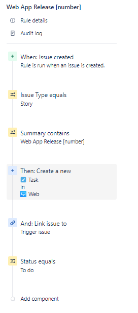

I am trying to set up an automation for a story with a specific summary that triggers the creation of task linked to the story.
Unfortunately this automation does not work...could you please help me?

I assume that your automation fails on the link issue component. The reason that one is failing is because you are trying to link the issue that triggers the automation to itself. The link between the new task and the trigger issue should happen as part of Create new task, or you would have to create a branch to do it.
