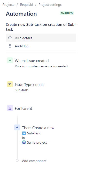

Basically, the Sub-task that you are creating has to have a parent specified. For this, you need to use a branch. Here is what I did -
The trigger is the creation of the issue. You can specify a condition for issue type.

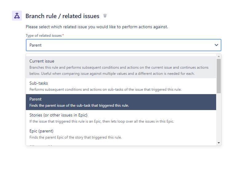

Then, you need a branch to say, on the creation of the Sub-task, go and check where it was created, as in within which issue, and add another Sub-task in the same location. That is to say, to have the same parent, as Sub-tasks cannot exist as independent issues.
Here is what the branch looks like. You need to choose here Branch rule / related issues and then choose the option, "Parent" from the list -
Please can you try to implement this solution and let me know if it works for you?

Hey there :)
It does work, but there are 2 problems:
1. I need it to stop after 1 issue is created.
2. I have other parallel sub-tasks for which need to perform the same operation, and if I try to create a restriction after creating 1 sub it does not respond to the creation of a parallel sub-task.
