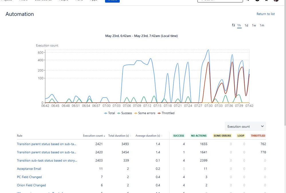

Automation "Throttled"
We are premium, have 400 users. We do not appear to be even close to our automation usage limit.
Any ideas why we are now getting throttled?
Automations, audit log, usage limit, insights report are attached.

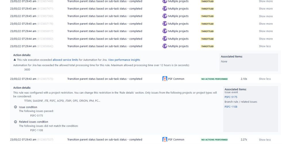

Looks like you have exceeded your allowed total processing time... Here is the link that shows the service limits. Check out the daily processing time for how it computes this:
https://support.atlassian.com/cloud-automation/docs/automation-service-limits/

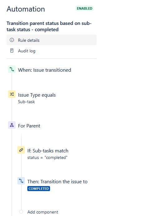

Yes, and...to Garrett's answer: based on the rules you showed, you could probably combine those rules (or make them more specific on the triggers' status values) to reduce execution triggering and execution time.
