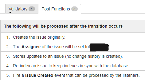

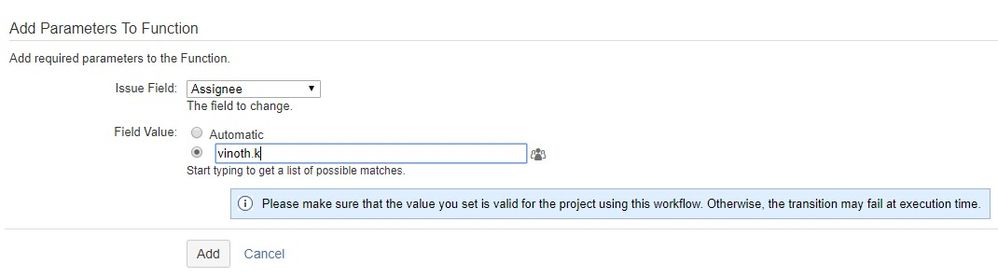

For Design Change issue type I have a separate workflow. So edited the workflow and added the Post Function - Update Issue Field. Please find the below snapshots.
I have added the post-functions and performed reindex. After that, I created the issue with my issue type (Design Change/Update) by default it's assigned to Project Lead.
Could you please suggest me on this....
Its bit urgent requirement -- Am using JIRA v 7.3.7

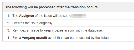

Hi Andrews,
you have to set the assignee in the first step:
This works for us.

Hi @Thomas Schlegel,
I have added the post function -> Stores update to an issue. under Assignee of the issue. Now it's working as expected.
