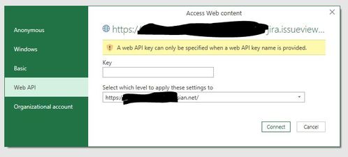

thanks @Thomas Deiler ! i'm having a lot of trouble trying to get the power query to work even after scouring the site for instructions. i created an API token and have tried to use the 'Web API' data source, pasting the key into the 'Key' line below, but get the error below.. any ideas? may be more of an excel issue at this point... Capture.JPG

Dear @Ryan O'Donnell ,
can you figure out, if the api token in general works, first? Use Postman and do some
https://***.atlassian.net/rest/api/2/issue/KEY-123
Replace KEY-123 with a real issue key.
You can also use a browser extension like https://restlet.com/modules/client/
