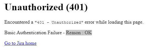

Unfortunately, this is what I get:
I get a "401" error but with the reason: OK.
This "Ok" confirms that my username and password are valid, although I get a 401 error.

The issue comes from the "Basic" method. The image above corresponds to the error I get on Postman with the basic authentication (the credentials are good and my account is in administrator of the platform).
I have indeed seen that this method is normally still available on Jira 8, that's why I don't understand why we receive a 401 error since the update.
