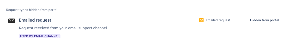

In your Service Management project go to Project Settings.
In the Navigation Pane on the right, about 6 items down, you should see Request Types. Click on that.
The screen should show you all the Request Types available for your project. Emailed Request should be only at the bottom and should show "hidden from portal".
Because of that, the users creating request through the Portal UI should not be able to select Emailed Request. Do you have "Emailed Request" showing up somewhere else in that list?
Above this entry is the list of request types the users can select from the Portal UI. Requests coming in from the Portal UI should only be one of those Request Types. Users creating issues through the Portal UI should not be able to select "Emailed Request"
Can you show us a screen image of your Portal UI and of your Request Types screen?
