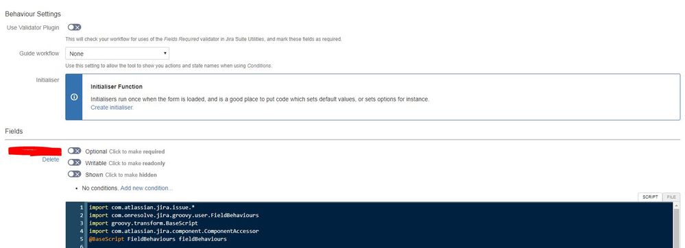

Can you also look at the below, I have changed this I am comparing custom fields on the same issue but ignore the script for now, is this in the right place? or should it be on the initialiser if I want to get it for parent duedate?

As far as configuration in behaviour is concerned, then your script should be mapped to the dueDate field in the sub-task for the field mapping.
