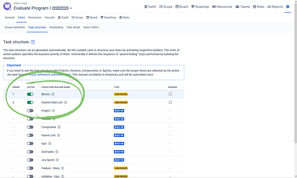

You can build the work breakdown structure in BigPicture's Gantt chart based on Jira issue links, see figure 1.

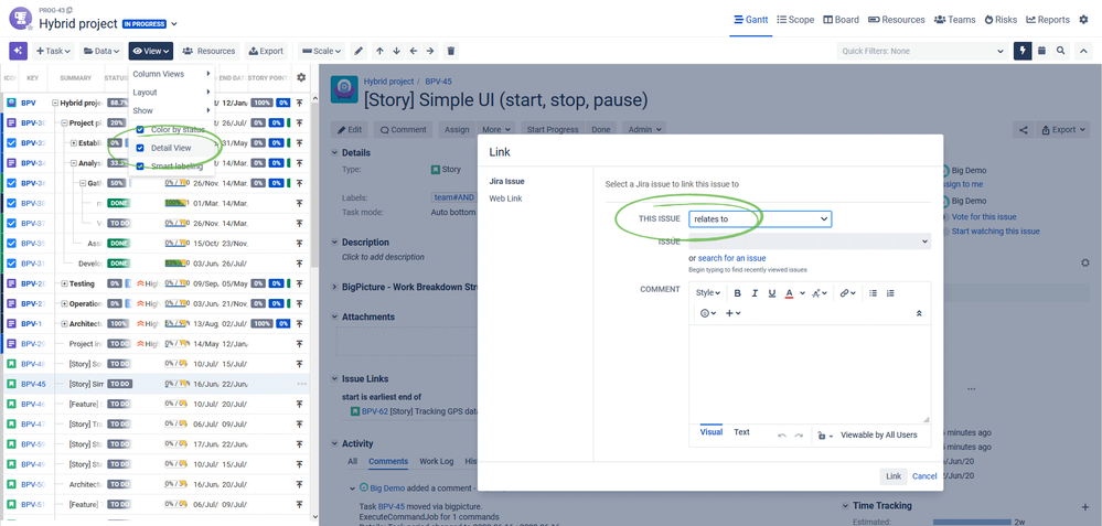

The only help I could think of was enabling the Detail view in the Gantt chart, see fig. 2, so that you could click through your issues relatively quickly and set Jira issue links on them.

Fig. 1
Fig. 2
