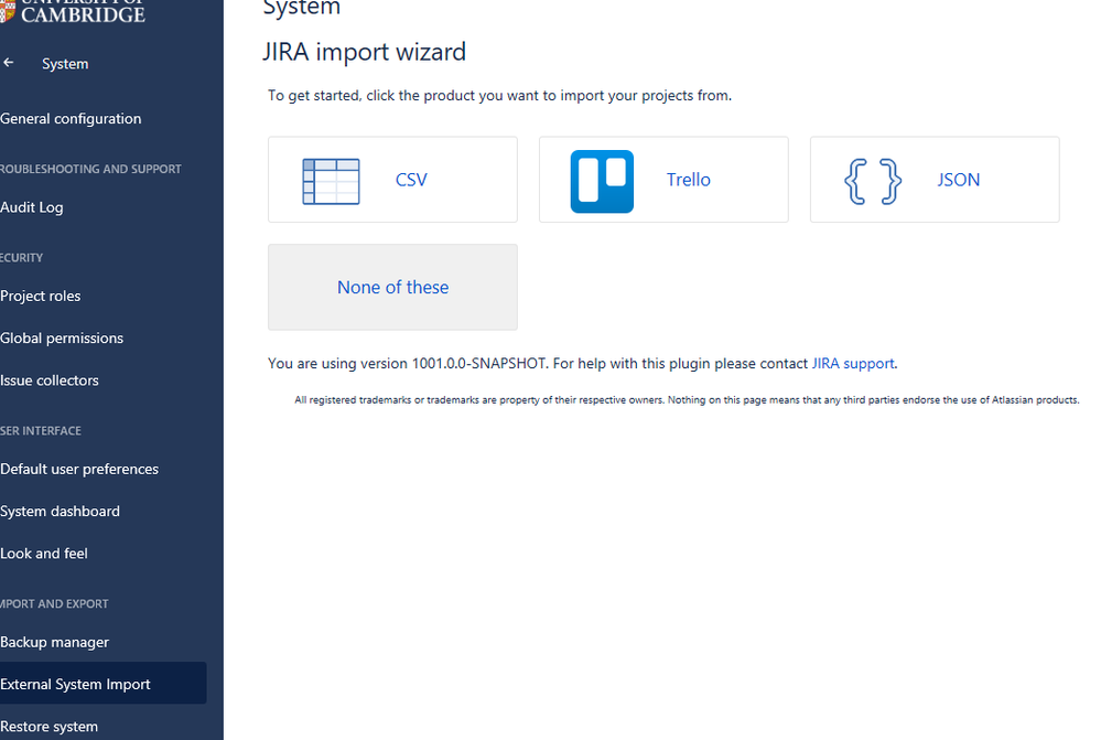

I can follow the cog icon ->__System__ (from the main Jira admin page)
But there is no option in the '__Import and Export__' section  '__Bitbucket__'
only:
- Backup Manager
- External system Import
- Restore Backup
Following the External System Import option provides the ability to upload JSON (as exported from Bitbucket; but not quite ;-))
Caterina Curti
July 12, 2018
Hi @Stephen Shorrock,
You are right that the option is called "External System Import" (I updated the reply above).
Which version of Jira is currently installed?
At which stage do you get the option to upload the JSON?

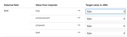

In my test everything is managed via the user interface.
This is where I'm asked which fields I want to map:
And here how to map the available values:

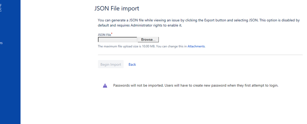

Is there a screenshot that you could share of the JSON import option?
Stephen Shorrock July 13, 2018
Hi Caterina,

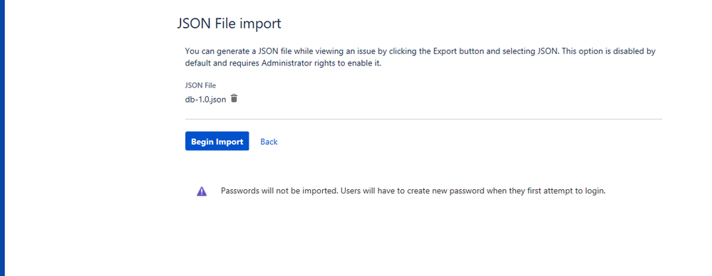

Thanks for you reply, it doesn't appear to give the options you have in your screen shot. It just attempts to upload the file then fails :-(
Then:
Finally:
