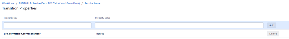

I am not managing to block comments on 1 status, while it worked for another. The same exact transition permission was used => jira.permission.comment.user
Your help would be appreciated in figuring this out

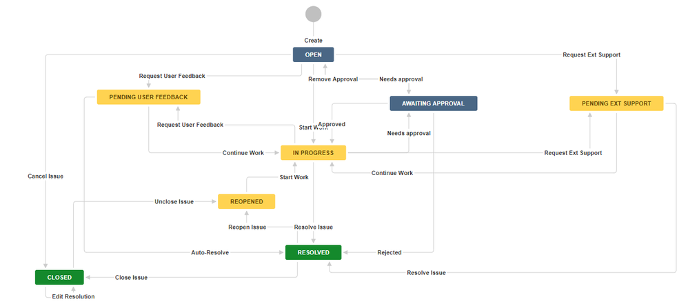

If an issue is considered resolved from ICT pov (JIRA resolution field is set), the issue no longer shows up in our teams their Queue, as there's no more followup to be done. This means the statuses "Resolved" and "Closed".
From "Resolved", a user can either reopen or close the issue using the transitions on the customer portal. If reopened the issue returns to "In Progress". If closed the issue is set to status "Closed".

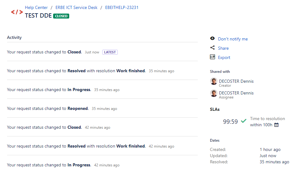

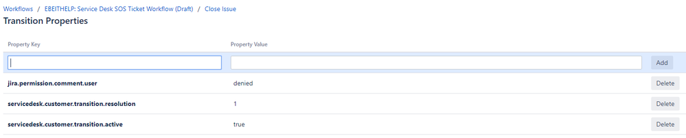

I've managed to use block comments on issues with the Status "Closed" through the transition permission jira.permission.comment.user = denied

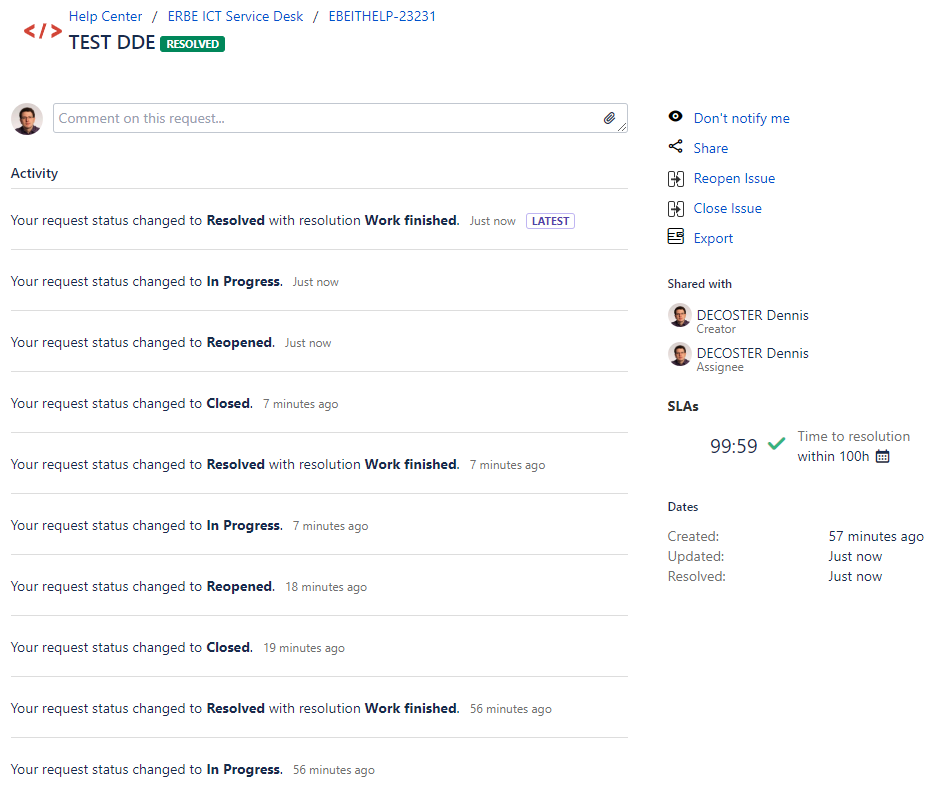

However, the exact same thing is not working for the status "Resolved".

I have reached a slightly different property: jira.permission.comment=denied, as per:
https://www.j-tricks.com/tutorials/permissions-based-on-workflow-status
jira.permission.comment.user = denied would allow the username "denied" to comment on the issue while in that status. Perhaps the Closed status is forbidding comments due to some other config?

Thanks for your feedback, I have removed the property "jira.permission.comment.user = denied" now that I better understand it's effect.
Also thank you for removing the "spam" tag from this question.
However in the meantime I had already opened a new question to which I got a satisfactory answer

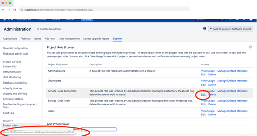

If still on the workflow permission scope, I'd try something like jira.permission.comment.projectrole=99999
With 99999 being the role id in your instance. You can view them by hovering the mouse over each of them in <your-jira>/secure/project/ViewProjectRoles.jspa as Admin.

No luck getting the Project Role ID on the page you referenced, neither in Chrome nor in IE. There was nothing being displayed on hover.
So instead I tried using jira.permission.comment.projectrole = Service Desk Team on the Resolved status which resulted in messages stating "The issue doesn't exist" when I tried to view any resolved issue in the project.
Any thoughts?

I'm sorry, I said mouse hover but failed to make it clear where would the id appear. See if this screenshot helps you:
On hovering the mouse over the edit link, for example, the address will appear somewhere on the browser. The screenshot os from Chrome on MacOS. The id here is 10200 for the SD Customer role.
