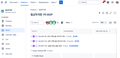

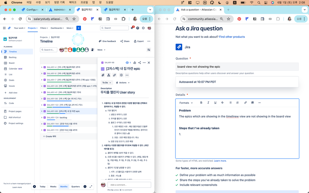

The epics which are showing in the timelinew view are not showing in the board view
Board view : 3 epics
Timeline view : more than 3 epics

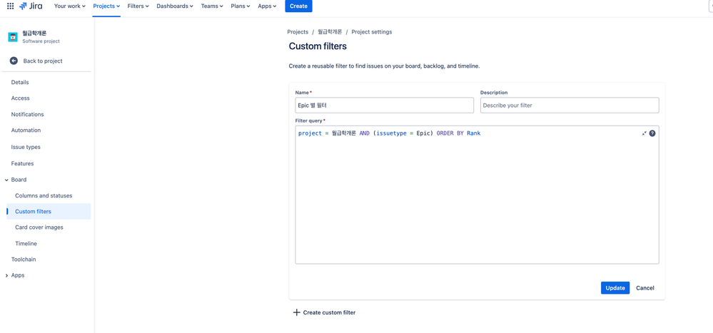

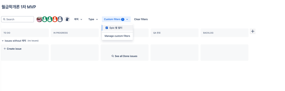

Configured Custom Filter (Epic search) : No (not showing anything)
project = 월급학개론 AND (issuetype = Epic) ORDER BY Rank

Can you check in your board settings and verify there is no sub-filter that is filtering these out?
Double check your board filter to make sure it's correct as well.
Also, if you go to Issues, and just search the project + Epic, do you see the correct list there?
Last, are these Epics done? Maybe you have the board setting turned on where completed cards older than 2 weeks no longer show on the board.
