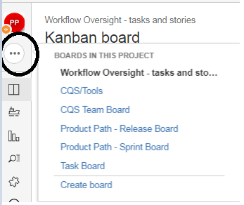

I have 5 boards in my project. In which one of my boards  disappeared.
Filter is not deleted. Project name is not changed. No change made.
The board appears in the project drop down rarely. Almost all times it is not visible. Strange, but no error messages in the logs.

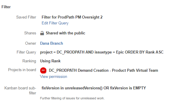

Please find attachment where i could not find that one board from the drop down.
Kindly help.

It's not a matter of it being null, we need to know what it *might* select.
Could you give us the JQL of the missing board please?  Feel free to obscure project names if you've got "project in (aaa, bbb, ccc)", I doubt that is the problem.
Krithica Gowri Shankar
September 27, 2017
Attached the query used.
