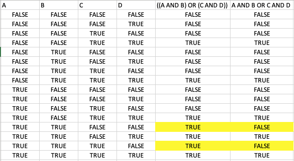

You will notice that JIRA has removed one pair of outer brackets. So, a query like ((A AND B) OR (C AND D)) is being changed to A AND B OR C AND D. I'll have to write out the truth table to confirm but I believe that these two queries will not produce the same results. Can somebody from Atlassian please review this and respond?

I created the truth table for both queries and I DO see differences in the results. I'm pasting a screenshot of the truth table. Unless there's something else I'm missing here, I think Atlassian should review this functionality and ensure that it preserves the brackets exactly as the user specified them.
I love this :) brings back memories.
Anyways for without parenthesis column what is your operator precedence - left to right or right to left?

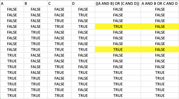

Actually, I found a bug in my Excel formula. I have redone the calculation and still see a mismatch. I'm pasting a new screenshot below for this.
In Excel, I used the following formula to simulate the L-to-R computation that Atlassian uses.
=AND(D2,OR(C2,AND(A2,B2)))

The Atlassian documentation says L to R but your truth table says something else. I guess the parentheses are still respected (at least in most cases).
