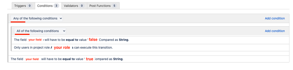

Are "true" and "false" the only values available for "Exclude from Controls"? Is that field always set to one or the other value and is never null/none?
If so then your workflow transition conditions would look like this:

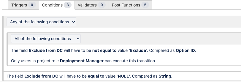

Below is how I have the settings

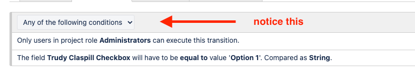

Hello @Nicole Pomponio
I think I overcomplicated it.
I think that this will work for you, but I recommend that you try it in a test project first.
Substitute values accordingly
Trudy Claspill Checkbox >> Exclude from DC
Administrators >> Deployment Manager
Option 1 >> Exclude
This should work such that
- anybody can transition the issue if Exclude from DC is set to Exclude
- users in the Deployment Manager role can transition the issue always.
I’ll test this out! For now, I have it working just by switching my Exclude conditions so that Deployment Manager and Exclude = blank are grouped, Exclude = True was separate, and it worked
