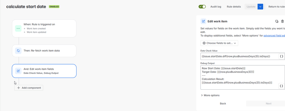

The debugging rule that I am trying (on sandbox), just to see if Start Date is read is the following:
Trigger: multi, item created/item updated
Action: re-fetch
Action: edit custom fields:
- Date Check Value: {{issue.startDate.diff(now.plusBusinessDays(3)).toDays}}
- Debug output: Raw Start Date: [{{issue.startDate}}]
Target Date: [{{now.plusBusinessDays(3)}}]
Calculation Result: [{{issue.startDate.diff(now.plusBusinessDays(3)).toDays}}]

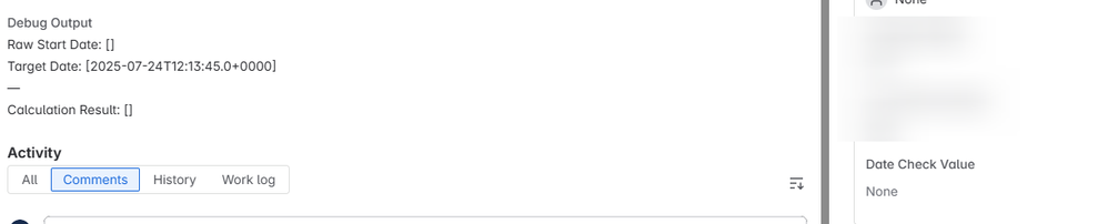

The rule is successful, however my field shows an empty value:
Date Check Value
None
Debug Output
Raw Start Date: []
Target Date: [2025-07-24T12:13:45.0+0000]
Calculation Result: []

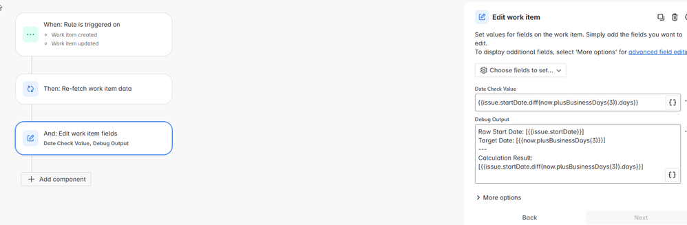

The syntax for the date / time diff() function just adds the units at the end, such as days and not toDays:
For example:
{{issue.Start date.diff(now.plusBusinessDays(3)).days}}
thanks for the correction, but still it`s giving no output. I will try to study better the diff

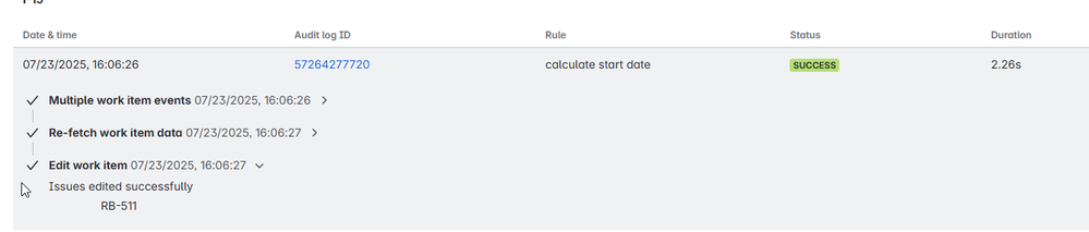

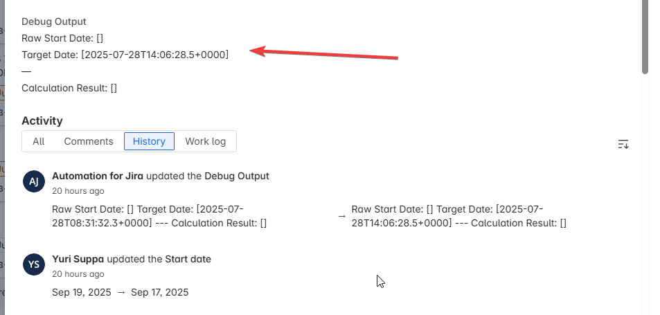

Hello, find below the Field value after the rule run, the history, then the details of the rule and audit log. The trigger was just editing the value for "Start date" as you can see in the history
Thanks for that information, and...
Please read my earlier post as your smart value for the field is still incorrect; unknown smart values evaluate to null.
And...looking closely at the image you posted, something seems wrong with the parentheses as some appear above / below the line.
Please delete that expression and re-type it to ensure the characters are actually parentheses and not some other special characters.
