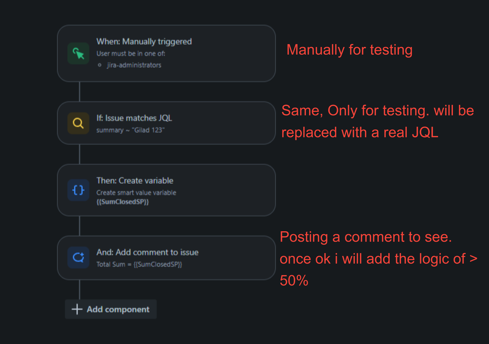

I would like to create an automation that triggers on schedule, filters with JQL relevant Epics or Stories (Simple query on a specific field) and per each, it calculates:
  • For Epic
    • IF Completion percentage (based on completed child issues SP) >= 50% then create tasks in a different Project
  • For Story
    • IF status = (In progress OR In review OR Deployed OR Done) then create tasks in a different Project
looking at a previous discussion (https://community.atlassian.com/t5/Jira-questions/Automation-Rule-calculate-progress-based-on-children-of-linked/qaq-p/2159555) led by @Bill Sheboy i still wasn't clear how to use the suggest smart value
Thanks..!

Hi @Gilad Waldman
I see two things with what you show:
1) There is no Lookup Issues action in your rule to gather the issues.
2) The expression you show is missing the closing parenthesis and digits for the ROUND function.  In my original post, I showed this:
{{#=}}ROUND((0+{{#lookupIssues}}{{#if(equals(status.statusCategory.name,"Done"))}}{{Story points|0}}+{{/}}{{/}}0)/{{lookupIssues.Story points.sum|0}}*100,0){{/}}
Bill
Gilad Waldman
September 11, 2024
Thanks @Bill Sheboy !
Although made these two modifications and don't get any error, the sum I get is "0".
Formula was fixed with your help :
{{#=}}ROUND((0+{{#lookupIssues}}{{#if(equals(status.statusCategory.name,"Done"))}}+{{/}}{{/}}0)/{{lookupIssues.Story points.sum|0}}*100,0){{/}}
And for this epic, i have 2 child issues, each has 3 SP - One is "done" and one "To do" so i was expecting to get "3" (or 50%)
Bill Sheboy
September 11, 2024
Please post an image of the audit log details showing the rule execution.  That may provide more context for what you are observing.  Thanks!
Gilad Waldman
September 11, 2024
Does that helps?
