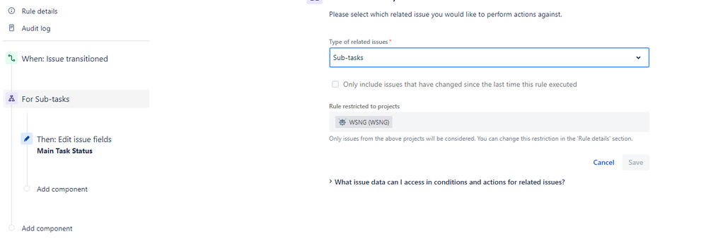

I added an automation rule which adds the father's status to its subtasks using an automation rule for every transition.
The problem I have is that I need to update the subtasks which had been created previously to that rule. I'm trying to bulk change those issues using a smart value while editing, the smart value which worked fine in the automation is: {{issue.parent.status.name}}, but it doesn't work while bulk changing I receive a string.

Can you show us the rule you have set up?

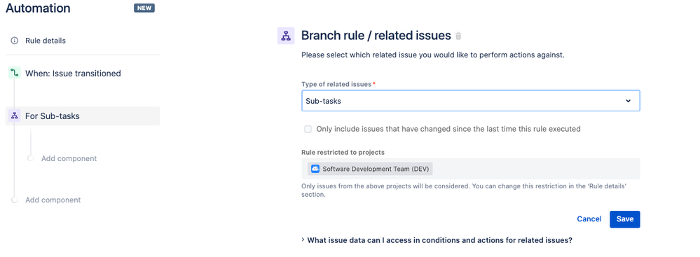

You should be able to affect all the sub-tasks that are associated to the issue at the time the rule runs, regardless of when the sub-task was created, using the Branch/Related Issues option.
