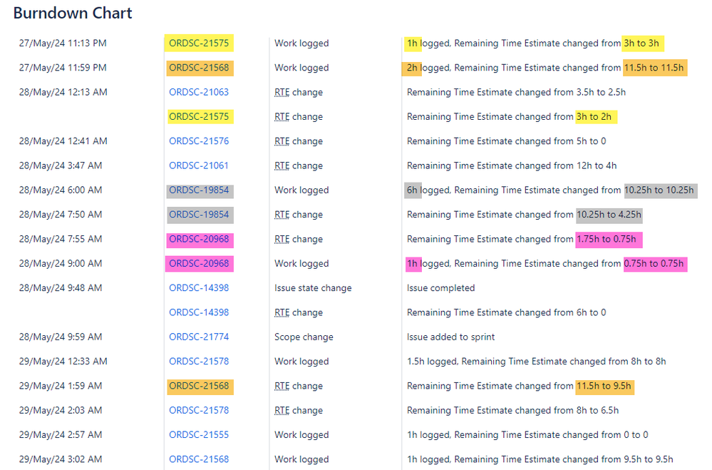

In my Burndown Report I see lots of entries like "4h logged, Remaining Time Estimate changed from 8h to 8h". The hours logged vary of course, but the Remaining Estimate doesn't decrement. If I look at the Estimate tab in the Issue I do see that the remaining time is accurate so it appears to just be an issue with the report. Any ideas?

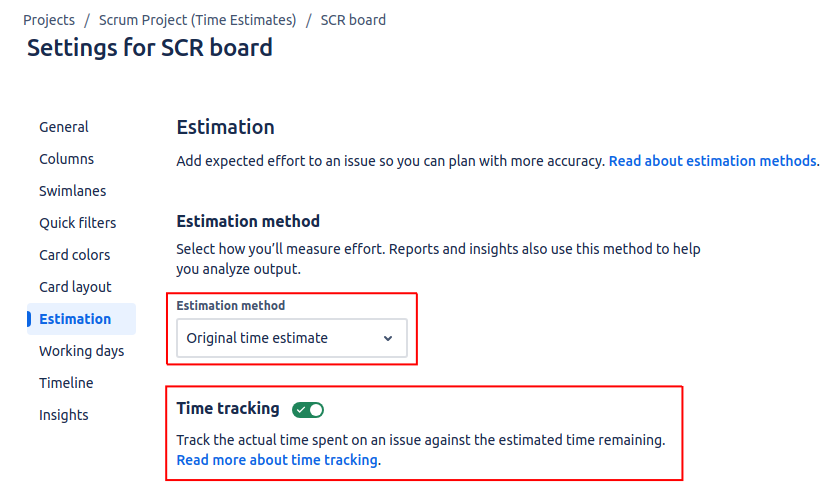

For the burndown chart to work based on time estimates, ensure that your agile board has Time tracking enabled.
Then, make sure you run the Sprint Burndown Chart Report by Remaining Time Estimate.

Following up a little late on this.
The image below shows the problem I'm seeing. Time gets logged but doesn't change the RTE, Sometime later (or in one case earlier!) the RTE is updated. It's just weird.
Silly question, but is the Burndown Chart configured to use Remaining Estimate? Even if that is what your board is configured to use as the Estimation value, the Burndown Chart can use a different value.
Given that you said that the 'Estimate' tab shows that the remaining estimate is accurate, I am assuming that you're using Remaining Estimate as the Estimation on your board.
Hi @Jon Platt I will admit firstly that I don't use time logging and so take some of what I have to suggest with a pinch of salt...I'm sure someone will correct me if I am wrong.
Burndown charts typically burn down based on 'Done' on 'not Done'. I like to understand this as you don't get the credit for the story/issue until the business value is released from it. If something is just 50% complete, how much business value can we get out of it? So that might be your first problem. For an issue with a 16h estimate, it can have 16h of time logged against it, but it's not done until it's moved to the Done column, and only then would it typically show up as a decrease on the Burndown chart.
There is also a Time Tracking report you may also want to have a look at, and Plans (was Advanced Roadmaps) can render a progress bar based on logged hours - as alternatives ?
