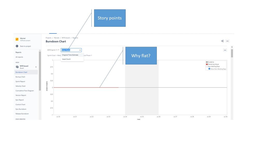

I am using story point estimate for the active sprint (1,2,3,5,8,13,21 story points) and based on rough calculation the total of this sprint should be at around 200SP.
Today is day 5 out of 10 working days.
I am checking my burndown chart, but why does it show flat like this?

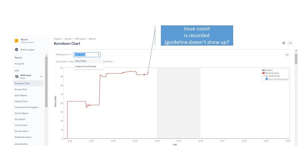

however, the issues counted graph is shown but without guideline:

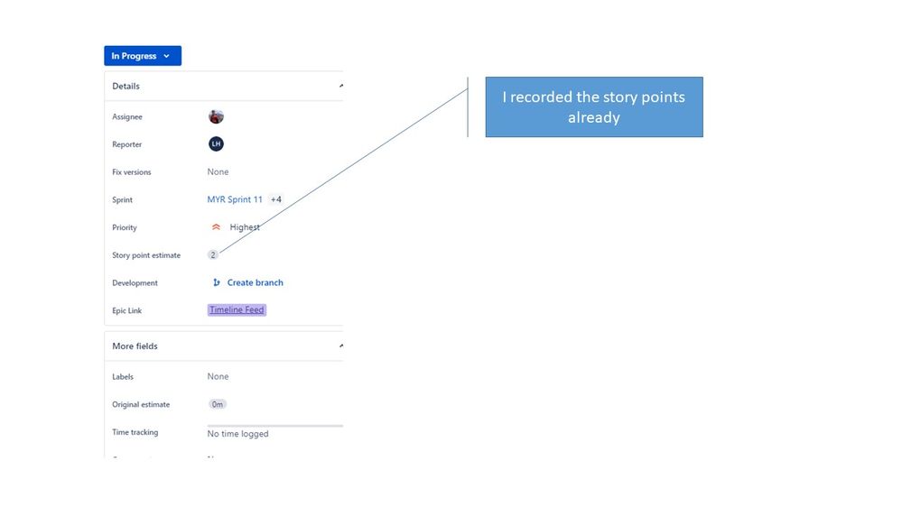

This is the detail of the ticketing:

In the burndown chart you have selected the "Story Point" selection, but on the issue you've populated the field "Story Point Estimate", which is a different. Field. Try to populate the "Story Point" field and run the report again. That ought to do the trick.

Somehow the guideline doesn't show... but it's fine, I need the story points line more. Burndown chart issue.jpg

Are you using a team-managed project or a company-managed project? You'll find this on the lower left hand side of your Jira page.
If you're using a company-managed project, the correct field should be Story Points
If you're using a team-managed project, the correct field should be Story Point Estimate
I have a feeling you might using the wrong field.
