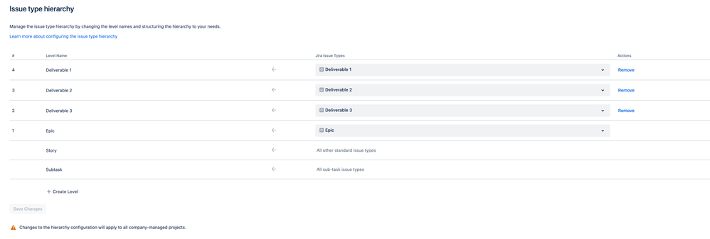

I have a project called "Base Project 3" which defines a custom issue hierarchy above the epic. For reference, the issue hierarchy is "Deliverable 1" -> "Deliverable 2" -> "Deliverable 3".

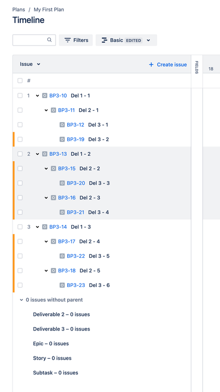

I have added some issues in the project and configured the parents as applicable. The issues are named to indicate their issue type. Here's how the base project looks like in Advanced Roadmaps:

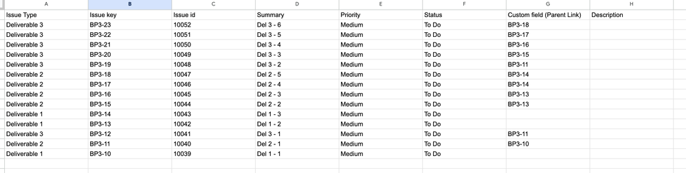

I exported this project to CSV with some selected fields, and it looks like this:

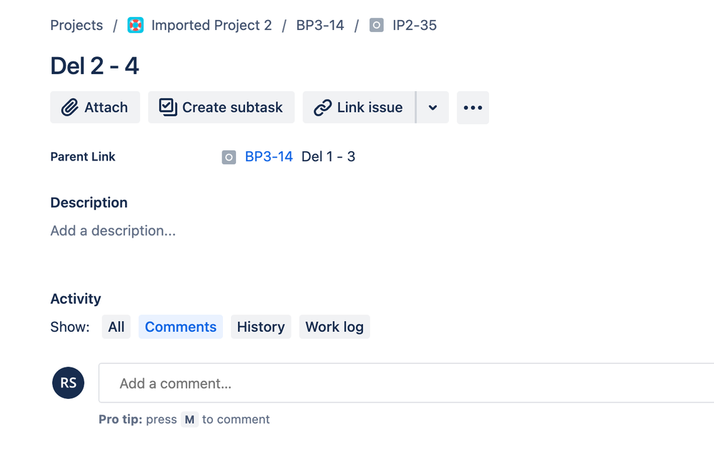

I want to import the CSV exported above into a new project, called "Imported Project 2". I first created the project, and configured it to use the same issue type scheme. When I went ahead and imported it, I could not map the "Custom Field (Parent Link)" and "Issue Key" fields for some reason.

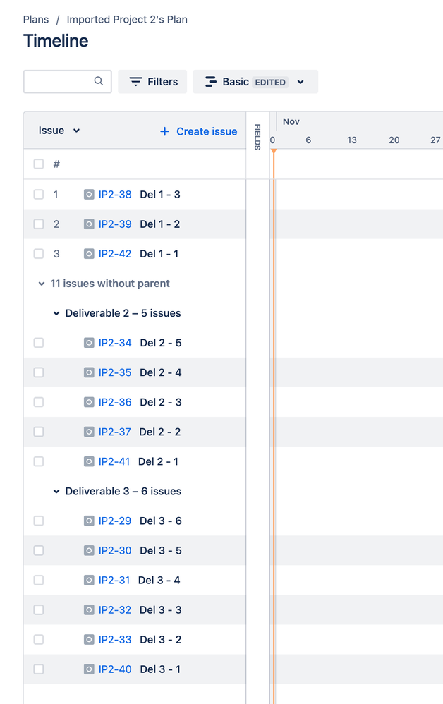

All the issues get imported with the correct issue types, but the parents are not set correctly. Instead, the issues map their parent issues to "Base Project 3".

I believe the problem is that you are providing an explicit issue key (i.e. BP3-23) in the Issue Key and Custom Link (Parent link) fields of your CSV file.
If you want the imported issues to be linked to other issues that are also being created during the same import process, you need to change the Issue Key values in the CSV to be unique numeric values, and then use those unique numeric values appropriately in the Custom Link field.
Examples:
Change all occurrences of "BP3-23" to "1".
Change all occurrences of "BP3-22" to "2".
And so on, renumbering all the issues in Issue Key and updating corresponding references in Custom Link.
