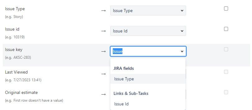

Ramu Konidena
July 28, 2023
Thanks for the reply - as shown above - I am not seeing Issue Key in the dropdown box - not sure what's going on - any ideas?
Regards.
Ramu

Ramu Konidena
July 31, 2023
No, it is from the same Jira instance. The csv file does have the issue key. As you can see the screenshot above, the source does have it. I tried creating a brand-new project and I see the same behavior (Gui does not give the option to select Issue Key mapping during export). I will try this with a different project in a different Jira instance later today and see what happens.
Thank you.
Ramu.

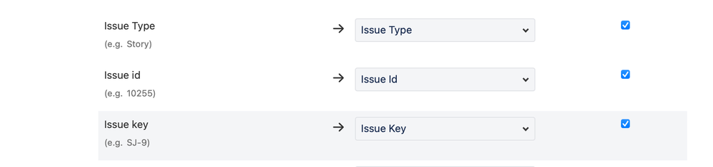

Suneetha Bandaru September 12, 2024
Hi All, after trying different things and going through articles, I found a work around for this.
- Go to "System" from the wheel icon option on the right side top corner.
- Open "External System Import"
- Switch to the old Experience (this is very important step for me to see the Issue Key)
- Select CSV option and proceed.
FYI @Teresa Douglas
Atleast for me, I could not find the "Issue Key" drop-down until I changed to old Experience. Hope this helps!
Like • Morgan Watts likes this
Mohanraj Thangamuthu
July 27, 2023
Hello, While importing the .csv file to update the fields you need to make sure to map Issuekey, issuetype field.
Ramu Konidena
July 28, 2023
Sorry for incorrectly posting my reply as an answer:
Thanks for the reply - as shown in the screenshot below- I am not seeing Issue Key in the dropdown box - not sure what's going on - any ideas?
Regards.
Ramu
