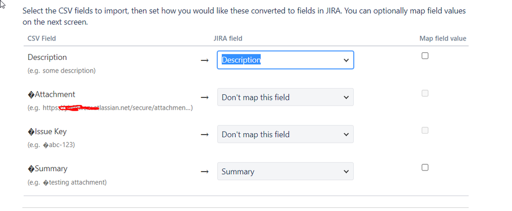

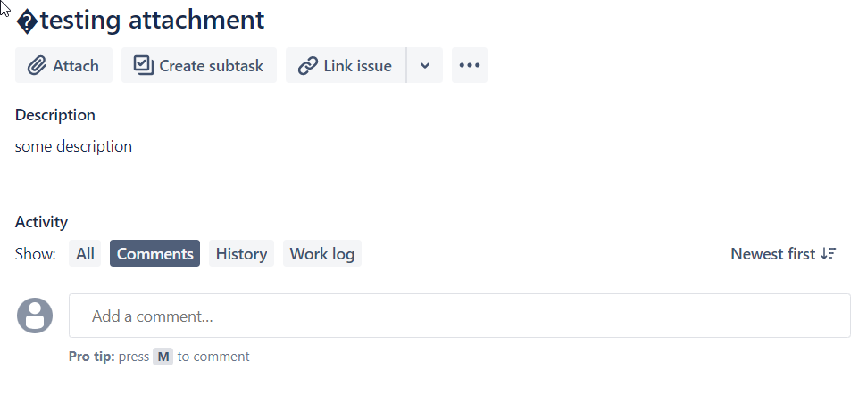

Tried it. First, it gave me an error that the Description is not given so, I added a column and set the following mappings
Didn't work.
Hello @Jack Brickey i am facing exactly the same issue regarding attachment and i couldn't find a solution. jira won't find/recognise/link the field "attachments" from csv to jira "attachments" (see seconf before last image above).
Can you please suggest another solution?
