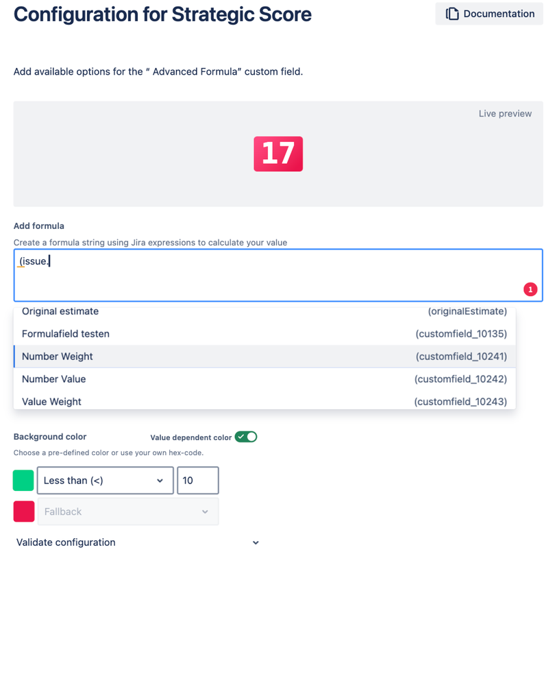

I just saw your thread, and I'm glad to hear you found a solution with Structure! If you're looking to take it a step further and perform calculations directly within Jira, while also visually representing scores with value-dependent colors for better awareness, you might want to consider using the Advanced Formula Field from Awesome Custom Fields.
Let's assume you have the following custom fields:
Impact value (numeric field)Impact weight (numeric field)Value value (numeric field)Value weight (numeric field)You can use the Advanced Formula Field to calculate the Strategic Score with the following Jira expression:
(issue.customfield_10241 * issue.customfield_10242) + (issue.customfield_10244* issue.customfield_10243)
As you can see in the screenshot, we have integrated an easy search that will help you find your defined number custom field, without having to look up the custom field ID. You just have to enter "issue." and the available number fields will be shown to you.
When you activate the value dependent colour you can also define a colour for a number range of your choice.
If you need any further assistance, just let me know.
