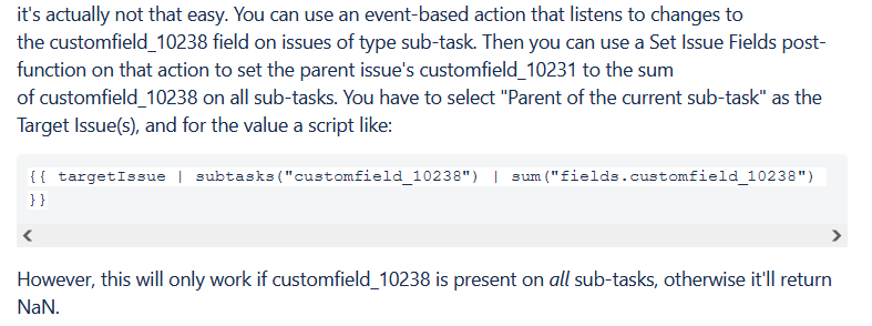

it's actually not that easy. You can use an event-based action that listens to changes to the customfield_10238 field on issues of type sub-task. Then you can use a Set Issue Fields post-function on that action to set the parent issue's customfield_10231 to the sum of customfield_10238 on all sub-tasks. You have to select "Parent of the current sub-task" as the Target Issue(s), and for the value a script like:
{{ targetIssue | subtasks("customfield_10238") | sum("fields.customfield_10238") }}
However, this will only work if customfield_10238 is present on all sub-tasks, otherwise it'll return NaN.

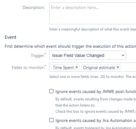

The customfield_10238 calculation should be triggered when there is a logtime entered. So I put the trigger on the update of the Time spent field.
Unfortunately this does not trigger the action. What is the error?
In the meantime I added Original estimate (and made a voluntary modification) to make it work
Because Jira doesn't trigger an event when that field is updated.
Have you tried listening to the Work Log Created event?

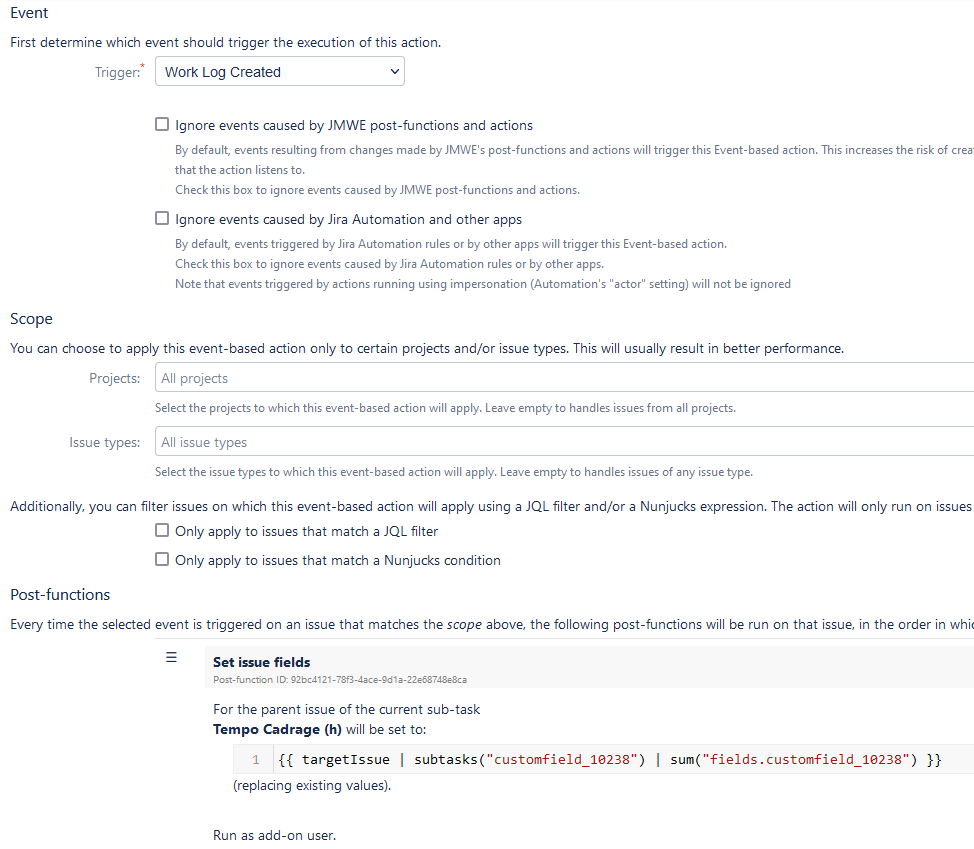

@David FischerI created new tickets and made a new test, but it does not work anymore.
The 1st logtime (7h) is displayed in the customfield_10238, but is not displayed in the Sum (customfield_10231) of the parent ticket. The Sum remains at 0.
I add a logtime (1h) on the same subtask, and the Sum displays 7, but not 8.
(Customfield_10238 and customfield_10231 are Number fields with the default value of 0). What is my mistake please?

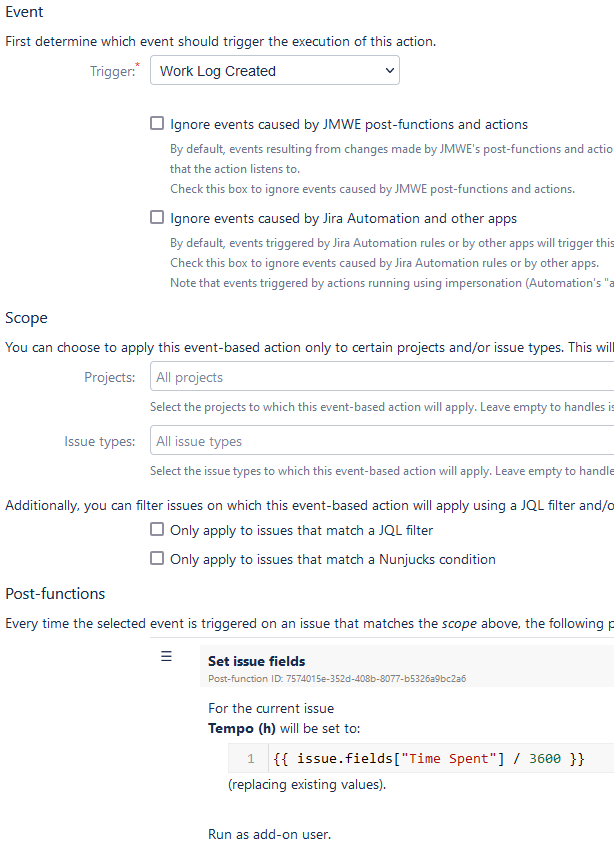

Sorry. I resume :
The customfield_10238 is filled with 3 actions :
the same with the trigger 'Work Log Updated'
the same with the trigger 'Work Log Deleted'

Since the second event-based action depends on the first one, you should use a different trigger. You should listen to changes to customfield_10238 instead of work log changes in the second action.
Yes ! Thank you very much! Yes, that was my old setting and I didn't remember changing it.
Thanks again for your help David
