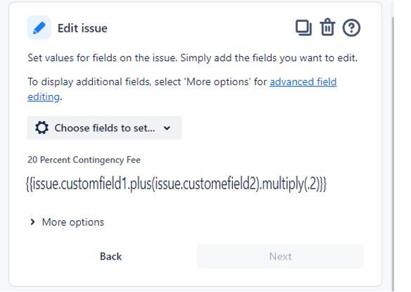

I want to add two fields together and multiply it by 20% but it's not working.
Is this correct syntax?
{{issue.customfield1.plus(issue.customefield2).multiply(.2)}}

Hi Trudy, I am using the edit field
Is my syntax correct to use multiply for a decimal point in parans?
When I used (.2) I got an error in the Audit Log for the rule. Do you get an error in the log?
When I used (0.2) I did not get the error, and I got the correct value.
okay, that's good to know. I did get an error when I used (.2) initially. Before I read your response, I changed it to (0.2) but have not checked it yet. I guess it requires #.# for decimals?
I just checked it and it is working now with (0.2) format. Thank you!!!
