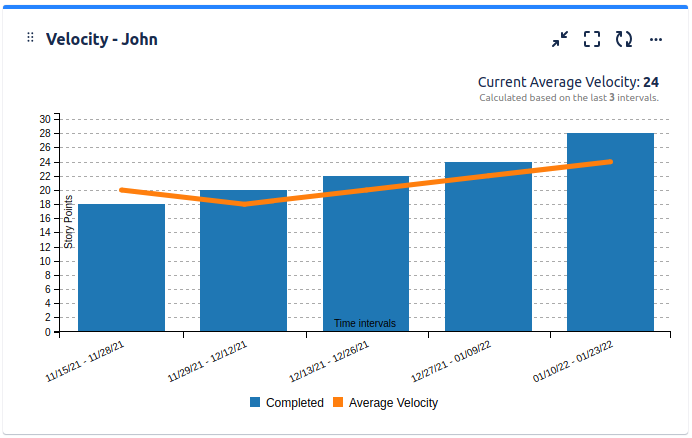

Be aware that there might be better alternatives to your current method. For example, you could also try these two gadget offered by our Great Gadgets app. But, again, both will calculate per time interval, not per sprint.
Advanced Issue Filter Formula gadget
Kanban Velocity gadget -  in this case, you will need a gadget for each team member
Hope this helps.

@Danut M [StonikByte]  I am looking at the help doc, but I am a little stuck at how to do the calculations. Do you have a screenshot you can share of the velocity by Team Member?
February 14, 2024
Hi @Isabella Musial,
Please contact our support team at support@stonikbyte.com and someone will get in touch with you right-away.
Thank you,
Danut
