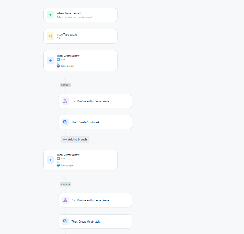

Here's how I currently have it set up which creates a Task and each of their sub-tasks but it isn't created within the newly created Epic. Any ideas?

We use Jira Cloud more like a project management tool so on each Jira software project board (we have several) there may be 100+ Epics but each of these Epics needs to have an identical set of tasks and sub-tasks.
A User will create an Epic and give it a specific, unique title. What I want the automation to do is trigger when the Epic is created and automatically populate it with the tasks and sub-tasks.
At the moment, the automation triggers when the Epic is created but it doesn't populate that Epic with all the tasks. The tasks it does create do not have a Parent.
Does that make sense.
