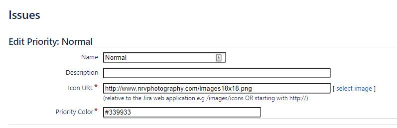

I have tried attaching an icon to an issue and right clicking to get URL but it does not work for me. I HAD an icon hosted on my website and it worked fine for years. Now JIRA cannot find it altho it is still on my website.
Can I add an icon directly to /images/icons/priorities?
Thanks.
I have tried that. Here is a screenshot of the URL:
And that is the link that shows my icon correctly.
It just started messing up today. Fine yesterday
You can use your own icons for priorities. As the site admin go to Admin > Issues > Priorities. Click on the edit and in the next screen you will need to provide an icon URL where the icon is stored (provided by you).
I can’t say what has gone wrong TBH. If it was working and suddenly stopped then either the icon is not reachable or possibly some bug. I use my own icons and haven’t seen any issues. Of course as this is Cloud we are likely on different versions.
maybe try a new storage location altogether.
I added the image to another website and still no luck. Looks like I will have to use one of the five icons they have. :(

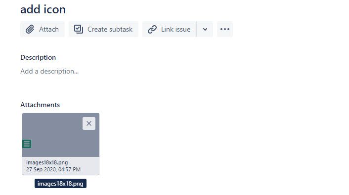

Hi @Ken Jacobs ,
Did you try to
create a test issue in your Atlassian instance
Attach the icon as attachment to the issue
Right click on the attachment on the issue and copy link address of the attachment
Use that as a priority icon URL when creating new priority/editing existing priority
Yes several times. But now I cannot even copy the link address as an option. Before when I could the URL started with "blog:"
But when you hover the mouse on the attachment, you will the url at the bottom of the page. Give it a try. With server, it would be like /secure/attachment/attachmentnumber/attachmentname .
Did you attach any screenshot? I do not see one
ok. Do you know the path of your attachments? You can find it even on the system page.? Right click on the attachment and open it on the new window. Look for the URL of attachment
Here are two URLs I came up with; neither work.
blob:https://virtualtechwriter.atlassian.net/c0743c80-0372-4688-b95d-25981d5964d8

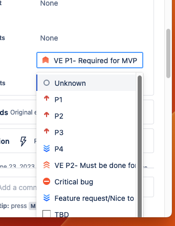

I have not been able to get this to work: Based on https://confluence.atlassian.com/jirakb/how-to-upload-custom-priority-icons-in-jira-788961156.html I should be able to, but even when I can get a link to an icon work (not easy!) the icon doesn't show up. Rather, on the edit priorities screen, the name shows where the icon should be:
And on an issue, the default icon (unknown, in our case) shows up, with no color.
Am I missing something?
