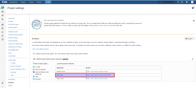

You should create a different screen for the edit view screen and remove the required field from the screen and attach the screen to the screen scheme in the project. I attached a screenshot:

There are three screens, which you can define for an issue: create, edit and view. If you have a filed only on the view screen and the field is not present on the edit screen, then you will not be able to edit the field.
What do you mean by nothing changes? You can still edit the field, can not you? If so, check that the filed is absent for the edit screen.
