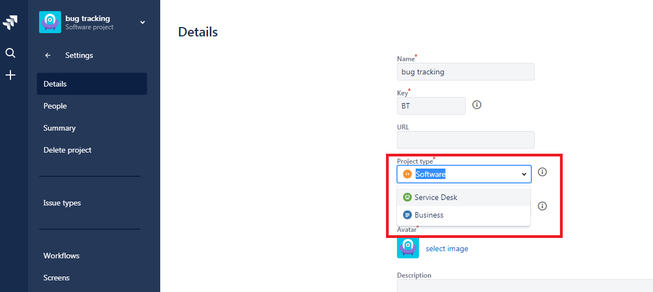

You can change the template.
Go to the Project Configuration and then choose the Details tab. You will be able to change the template there:
Be aware that this only changes the project "type".
The "template" is only used when you create a project, it's just telling Jira how to do the initial setup. Changing the type will not re-configure the project.
Yes I am looking to change the template. Currently default is set to SCRUM but I need to change to something else now. This is not possible?
Scrum is a template within the "Software" type. As I said, only the type will change.
You can not change the template once the project created. You need to delete it and recreate the project.
That's what we said before.
