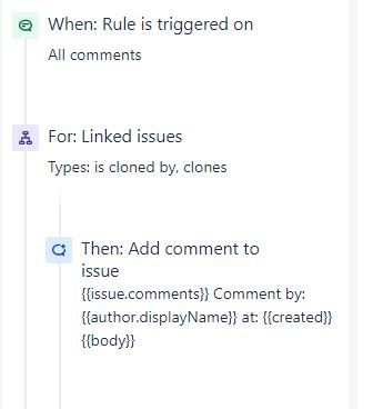

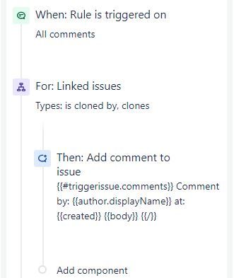

The first screenshot is what I originally had when trying to copy only the most recent comment but the then realised I was interating with the #.
I then changed it to this :
All this did was make a copy of the destinations comments and create a duplicate and not take the newly added comment.

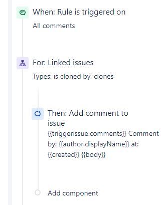

Then I tried this ...
This time I at least got the latest comment but it was part of the copy of all the triggerissues comments. I wasn't using the # character so it should have taken only one of the comments. Or am I wrong?

1) I have managed to copy all comments from the original ticket to the clone by using the triggerissue.comment BUT this takes all comments made and puts them into a single string so there is no way to see where the one comment starts and the other ends. Also has no user or date/time stamp per comment. It also creates a duplicate comment on the target ticket.
2) If I update the new ticket with a single comment, it now combines all comments together and passes everything back to the original ticket.

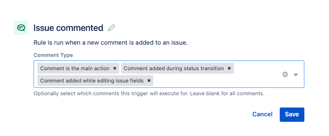

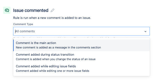

When you use the Issue Commented trigger you can change the comment type selected to get just the one comment added. If you don't make this change and then use the {{comment}} smart value, it will take all comments from the issue.
