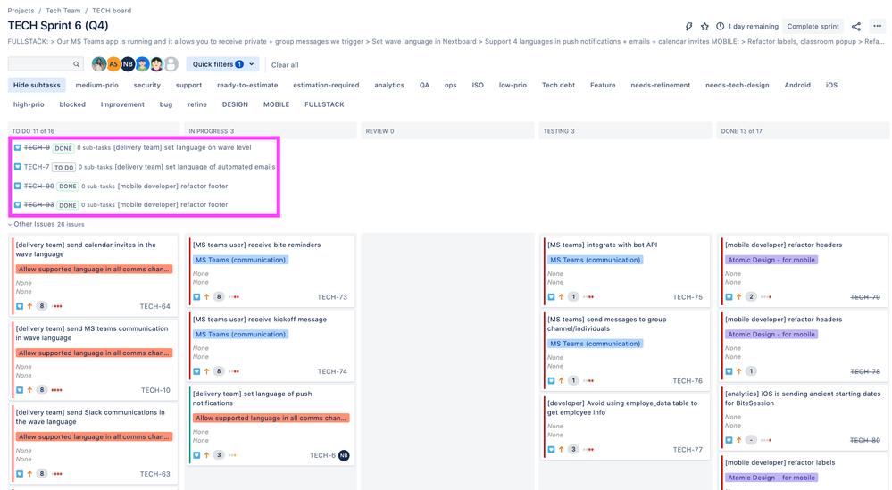

I was wondering if there are some tricks to do the following in my active sprint board?
1) Order of tickets
Can I reorder the order of tickets from top to bottom. We used to use Gitlab before and this is how we would communicate to the team which tickets to pick first (top to bottom from the open column) Or is the only way to use the arrow option in the ticket, and not a drag and drop in either the backlog view or in the open column in the active sprint?
2) Adjust view to only see user stories (no subtasks)?
Is there an easy way to only see user stories and not show subtasks in the swimlane column? Currently I see it like this which is not easy to get an overview so I would love to only see the user stories itself.

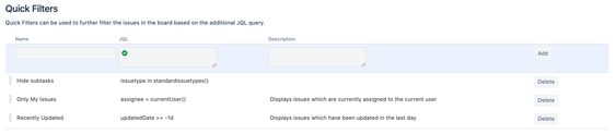

About the subtasks: yes. It may even be a better idea to add quick filters to your board. In that case, forget about modifying your board filter, but instead go to Board Settings > Quick filters and add a new quick filter like this:

However regarding the quick filter for "hide subtasks" the problem is that it just doesn't show the subtasks. What I was hoping for is that those tickets will then all appear in the same format of cards (if subtasks are assigned or not). Currently tickets with subtasks are still shown as a line of text vs. tickets without subtasks are shown as cards.
Does this make sense!

so here is what I tried:
1) setting the filter query
Project = TECH and issuetype in StandardIssueTypes() ORDER BY Rank ASC
--> which works so that the subtasks disappear from my active sprint board. However I was wondering if instead of this setting there would be an easy toggle on/off option to either show subtasks in swimlanes or not.
2) Added quick filter
Then I added your quick filter "issuetype in standardissuetypes()" but this then shows up in the board like my last screenshot

thank you so much for trying to help me out. Unfortunately if I follow the 3 steps and then use the quick filter "hide subtasks" it will completely hide user stories which have subtasks....
Can you share screenshots of:
