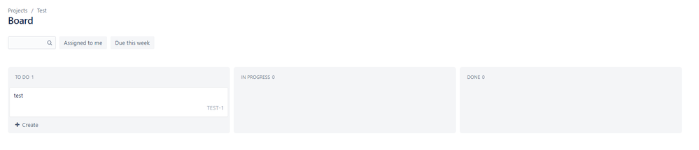

Hello Everyone,
I tried to activate the roadmap that is mentioned to be available on the classic project too.
According to this https://confluence.atlassian.com/jirasoftwarecloud/enable-and-disable-the-roadmap-1004952906.html , I need to change some board settings which I cannot found in my project page.
2020-09-11 18_05_24-Test - Jira.pngThen based on the notice at the top ( https://support.atlassian.com/jira-software-cloud/docs/configure-filters/ ), I need to configure filters which I need to be:
  • project administrator for the location of the board
  • board administrator for the board itself
For free plan, does everyone in the group is basically a administrator?
Please help me on this as I think I need the roadmap features.
Thank you!

Calvin Tanudjaja September 13, 2020
Hello John, thank you for the welcome greetings.
I just found out that the problem is not with the board settings but with the project template. I am using business project template rather than software development template. I think that's why for the business project board there is no settings like the software development project board.
I solved the problem with creating new project using software development template and I can use the roadmap features!
Thanks!
