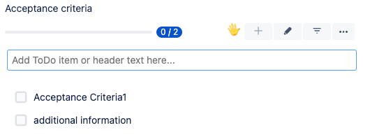

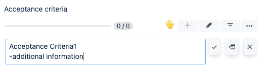

I am attaching some screen shots.
I do not want the add info to become a different AC.
1. write AC and additional info.
2.Additional information become different AC.

If yes, then in the In the documentation I found that:
In general, every new line is a separate checklist item, unless it starts with:
  • >> for description, or
  • # for the name of the checklist in the Checklist Text custom field, for example: # Default checklist
Since I don't have the app, I recommend you experiment with using ">>", as it seems to be your only option here.

@y.kanehira Patrik is right - with Acceptance Criteria you can add additional descriptions to items by adding lines starting with >>, and you can give titles to your checklists (if you have Multiple checklists enabled) by starting a line with #.
You can also add headers to your checklists by starting a line with ---.
