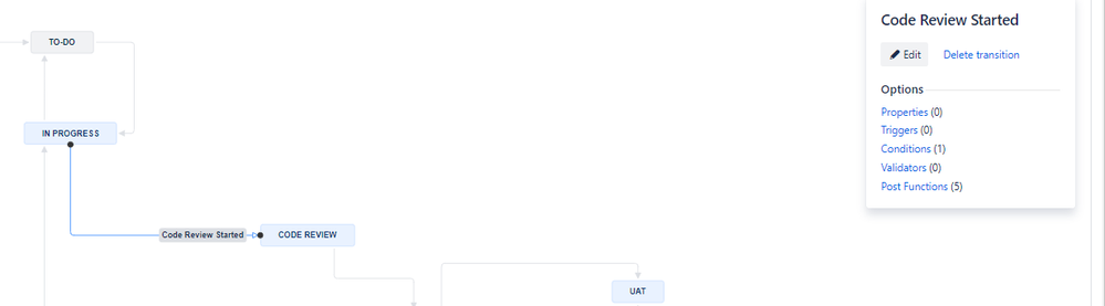

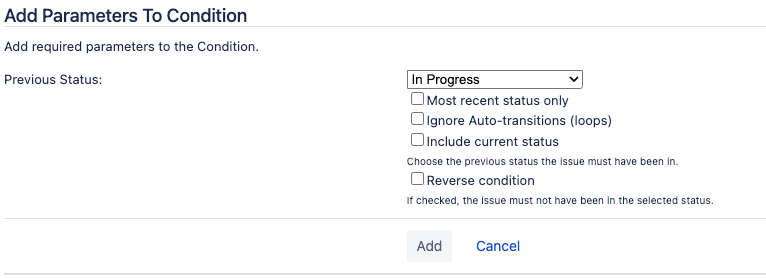

@Marco Brundel - I'm not sure if it works for me. I have added the condition from In Progress to Code Review Status:
I have not attained the results I wanted...I have attached the screenshots for reference. What I want is If story is moved to first time from In Progress to Code Review then Testing...
Moved from Testing to In Progress again. When from In progress, it should move to testing directly not Code Review because it has been in this status already.

Hi @Hizkeel Khan ,
It is then important to make a transition from In Progress to Testing. On this 'new' transition I would put the status 'Code review started' in the 'previous status' condition and not check 'reverse condition'.
On the transition 'Code review started' I would put the status 'Code review' in the 'previous status' condition and a check mark at 'reverse condition'.

@Marco Brundel - Sorry for the late reply. I have tried it and it works perfectly fine. Thank you so much!
