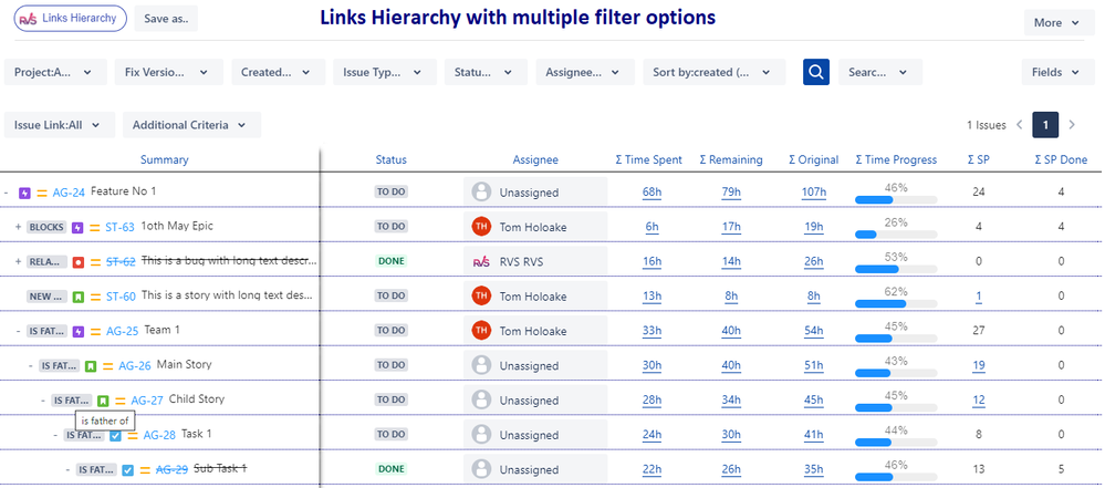

If you would be interested in a paid app, to visualize the hierarchy based on the issue links, we have created an add-on to track the issue links and issue progress at each level and for cross project links as well.
Pls try it out.
Agile Tools - Epic Tree, Links Tree and Time in Status
Key features of Links Hierarchy:
