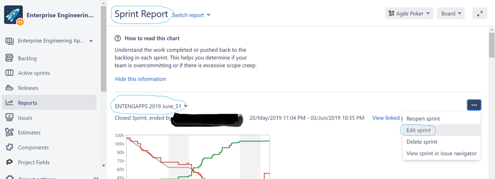

To rename a Completed Sprint :
Go to the 'Report' Tab and select the 'Sprint Report' in the dropdown.
Select your Sprint from the dropdown. Click 'Edit Sprint' and rename it.
Majo
Hey @majofrancis
I actually just tried this with no luck. I only have option to select reopen or delete sprint. Can you point me in the right direction?
Hi @Chau Vu
I am not quite sure why the "Edit Sprint" option is missing for you. Can you please verify your project permissions to manage Sprints ?
FYI I am logged in as JIRA-admin and my instance is JIRA 8.5 server version.
Please PFB the screen snip from my instance.
