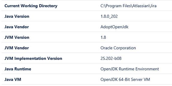

×Our Jira application v8.8.0 is using OpenJDK Runtime Enviroment Java Ver 1.8.0_202 and we wanted to know if it was safe to remove Java 8 from the server.
Yes, probably.
You need to check exactly what JVM your Jira is relying on, as you can't remove that if you want Jira to run. But in most modern installs, Atlassian stuff runs on a local JVM, not the system one, so removing a system installation of Java from a box will not affect it. You actually have to do a lot of fiddling to make an Atlassian system run on the system Java, and it's not recommended!
Thanks for the info, I believe that is what I was searching for.

Well the issue is our security team wants us to remove Java 8xxx from our servers and replace with a version on OpenJDK, I can see under our system info that the installed app is using OpenJDK, I just wanted to make sure that removing java is not going to effect the performance on the app server
Thank you for the response
