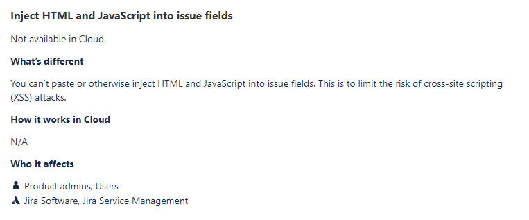

I read that it is possible to put JS/HTML in issue fields, but it seems that wont work on cloud (see image). We are presently on server but moving to cloud because it is more  restrictive ;-)

Yeah, I really don't know of a way to do it. Seems to me there is a need for an app that can list issues seen by users in a particular time period. But I know of none that exist.
