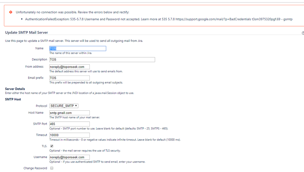

i try config email outgoing but show error blow:
Unfortunately no connection was possible. Review the errors below and rectify:
Username vs Password -> i Confirm correct.

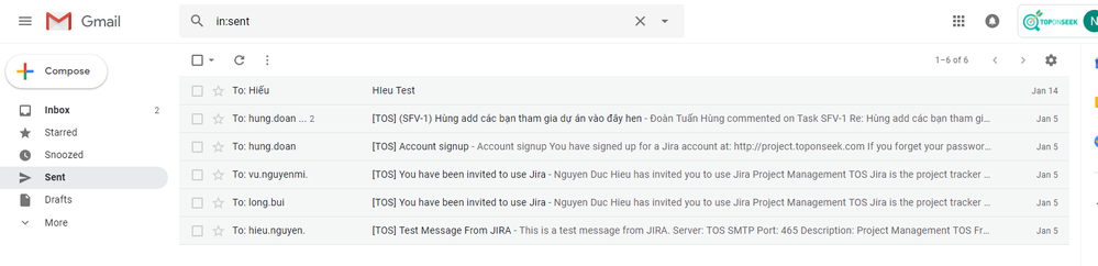

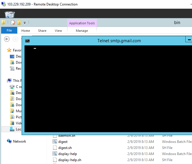

Can you try to do the telnet request to smtp server and see if you are able to reach(do this in your jira server's console)?
telnet smtp.gmail.com 465

Telnet working well,

Here Error when i send email test:
An error has occurred with sending the test email:
com.atlassian.mail.MailException: javax.mail.AuthenticationFailedException: 535-5.7.8 Username and Password not accepted. Learn more at
535 5.7.8 https://support.google.com/mail/?p=BadCredentials y66sm1825081pfy.66 - gsmtp
