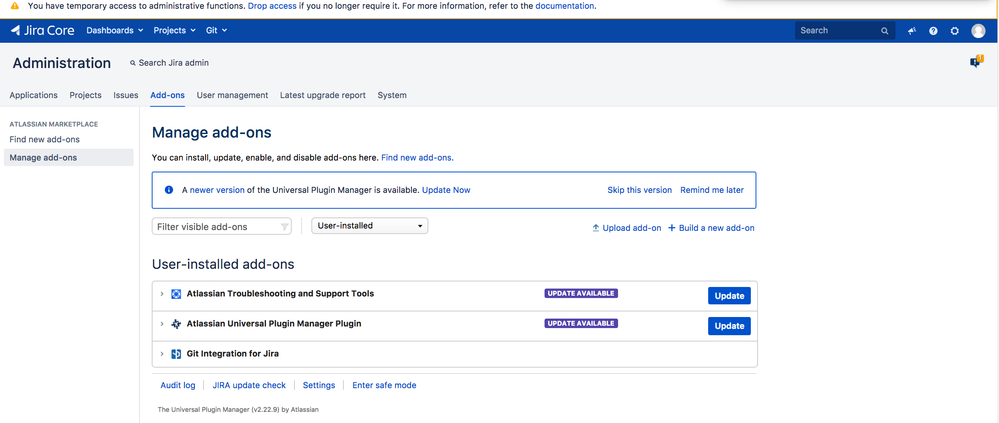

You should go to cog item -> add-ons. Choose Manage add-ons:
If you still can not see the button. It means you are not a System Jira administrator.
Problem is fixed now.

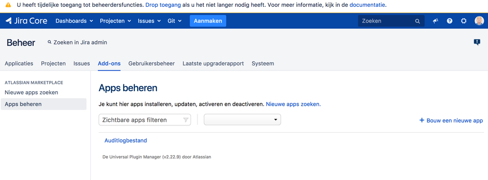

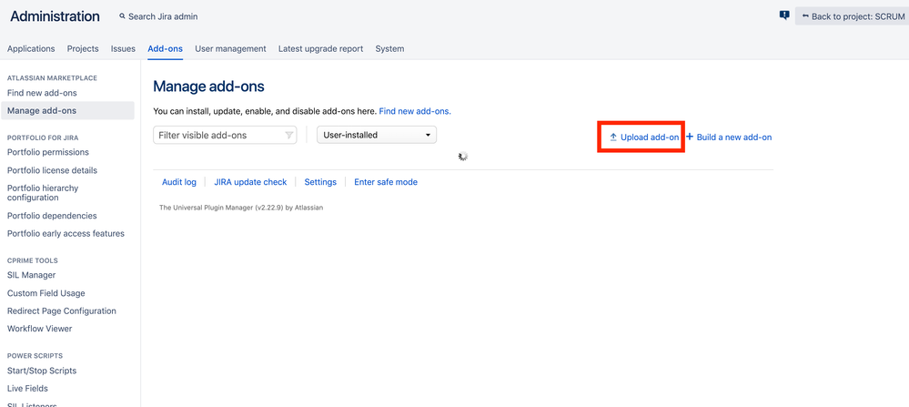

I have done two install, on a local Debian server (behind firewall and with dutch language) and one on a remote Debian server in a datacenter (with english language.) Using the same install procedure.
With the install on the remote server, I immediately saw marketplace-apps when clicking on 'Find new add-ons' while I didn't see this stream on my local server.
So I assume my local server, or the Jira Server application, can not connect to the internet correctly (while the whole Jira-Core install procedure went well actually and downloading the .bin files was possible), which result in not showing marketplace add-ons, and Not Showing the Upload Button. (The only need for that button is actually if you don't have internet, right?)
Screenshot of local server with NL language
Screenshot of remote server with EN language
