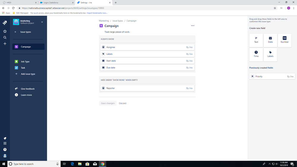

This is where I'm at now. Would I just add the issue type manually? (Where it indicates " + Add issue type")
Or am I still missing something?
I see. It is an Agility project. You can not change the issue type scheme for this project. There are no sub-tasks for this project. You can read it here:
Right, I see now. So I guess I would have to use a different template if I want to use a custom issue type scheme? Like Scrum or Kanban?
That is right.
