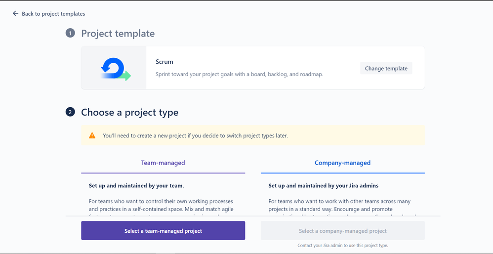

Pramodh M
January 3, 2022
The Permission for Creating Projects are governed by global permissions in Jira
For creating Company managed project you should be "Jira Administrator"
For creating Team managed project you should have "Create team-managed projects" permission
Don't give them permission to create company managed projects for everyone, that's not a best practice and you would not be using the tool is meant to be
Instead, all the users to group and grant them "Create team-managed projects"
They should see the below page when they are creating the project when they have permission to create the team-managed project
Pramodh
